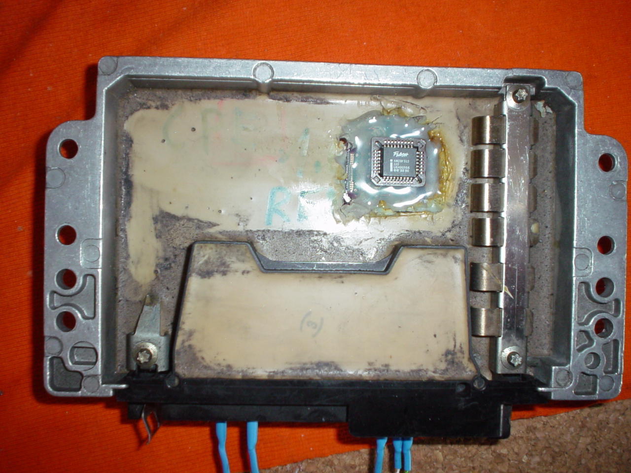

elettronicaautronica Inviato 1 Aprile 2011 Inviato 1 Aprile 2011 devi cercare sotto la resina la memoria plcc32, e poi nn ricordo quale pin devi mettere a massa per un millesimo di secondo per scodificare... 1.pin 37 - cut from ecu 2.conect ecu to car 3.ignition on 4.in 27c512 memory pin 22 circuit a few to tens times to ground 5.immo removed

elettronicaautronica Inviato 2 Aprile 2011 Inviato 2 Aprile 2011 safir 5 It's very simple !!!!!!!!!!!!!!!!!!! remove ecu with car 1. you find position flash and remove gum don't take out flash. 2. add suply gnd 2,3 pin +12V (15) 24pin +12V (30) 32 pin 43pin LAMP MIL (masa), second terminal +12V - connect 12/5W probe lamp Your probe lamp must be blinking - sygnalise immo IMPORTANT IT'S 100000% working first cut immo wire to ecu.use the light on dash (engine mngt not red led)for blinking ref. one side of the flash is A side the other b side (lets say) you have 9 pins either side,so 9 on A and 9 on B, short 1A with 1B then 2A with 2B all the way till 9A and 9B.holding each for at least 2 secs, engine mngt light should go out,car will then start. note:you may have to do it more than once before light goes out but believe me it WORKS. If your mngt lamp stops blinkig - ecu erase memory tms OK cut 37 pin and mount ecu in car - your car now has no immo

corrado Inviato 20 Agosto 2020 Inviato 20 Agosto 2020 scusate consiglio per togliere la resina grazie
corrado Inviato 20 Agosto 2020 Inviato 20 Agosto 2020 È possibile avere una foto per capire se si stacca qualche cosa?
